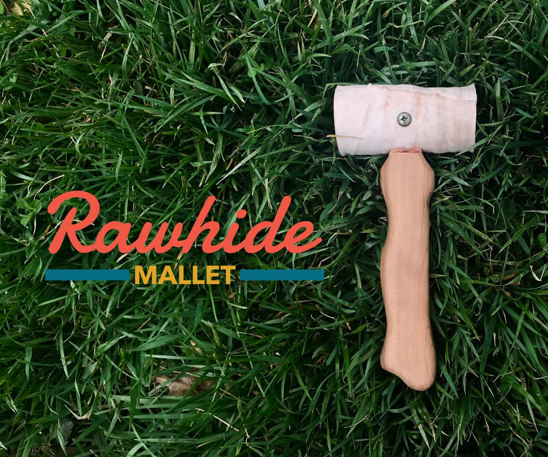

I have a leather faced hammer that's lost its leather face and needs replacing. Wondering if anyone has done this before or maybe some general leather knowledge.
I glued and rolled round faces (middle), rolled up using contact cement and glued the with liquid nails to the hammer recessed pocket. Question is the original leather face (left) was more ridge like it was set or cured in a way that it rigid. The leather I replaced it with was from shoe construction more pliable.

That's because these hammers don't use leather. They use rawhide.
This.
Rawhide hammers are commonly used in numerous industries, including metalworking, and the rolled rawhide faces are available in a number of standard diameters for replacement.
Rawhide is also stiffer than leather in most cases.

I was looking at this awhile ago and I found there are quite a few YouTube videos available.
The short version is you get a rawhide dogbone, boil it in water to make it pliable and wind it into a mallet head. It’s on my to do list.

Leather faced hammers are a really old technology. I get it, I like old traditional stuff too. But try no to spend too much time on this. Replacing the leather with a slug of lead, Delrin, or hard rubber might all be better choices. My guess is, what you've done won't hold up. But that just gives you a chance to try again.
Remember: all non steel hammer designs sought to mitigate shock. Not so much for the user, but to reduce damage to the struck surface. Any material with a young modulus less than steel will work. Even aluminum. Specific materials have been chosen for durability, and density primarily.
