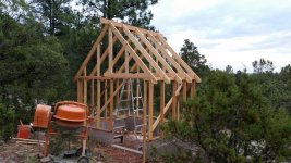

First I had to build a couple of sheds to store my spare car parts and tools that I don't use often.
Hmmm need to spam a couple more posts for embedded pictures... Spamming achieved:
First time doing block work... It's a little rough
Also first time doing a ridge board... Again, a little rough

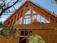

On to the roof framing!
The dormers are supported directly to the foundation over 2x 1.75" x 14" LVL's. Overkill, but we can get 6+ foot snow drifts. I may or may not have used that drywall lift to place each piece of the beams haha.
Making my rafter template. This was interesting with a 16' 2x12 and our on going weather.
Probably not necessary but I doubled up the ridge boards.
I decided to splurge and get the lssu brackets for the rafters. These were spendy, but man that simpson strong tie catalog just made me feel warm and fuzzy...

Winched that shed out of the barn to see what I have to work with. Construction is a little odd, the two sides of the barn are not really connected. I'll be changing this.
I removed ~4 inches of rat poop to discover the support posts are rotting out. Note the "water line" of rat dooky :p
Interesting timber frame like structure. I think the house is built the same way. This all looks like ponderosa pine, likely milled from the property.

Slow but steady progress.
I've finished the new load bearing wall section. This involved cutting out sections of the concrete, digging, placing a new footer, and building a new wall to carry the roof load.
The main reason for this is that I intend to link the two structures together and this new(?) wall will carry the new roof load.
I tied the old wall and new wall together as this section will remain and carry some retaining wall load.
A nice 9ft opening that will eventually link these two structures.
