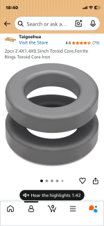

We installed 8’ led strip lights in the shop and now the door remote doesn’t work unless the lights are off.
I put ferrets on the hot and neutral of each incoming wire of the fixtures, wrapped the opener pwr cord several times through a toroid, put ferrit on opener pwr cord, and on control wires. Did not help. What else can I try?

Some, not all LED lights create significant RF "hash". In my shop, with the lights on, AM radio stations have so much interference that they're not worth trying to listen to.
The opener power cord isn't how the interference is getting to the opener receiver. Try extending the opener antenna or move it closer to an outside wall.

Like the others said it is not coming through the power cord. Turn on an AM radio and then turn the lights on and off and you will see what the problems is. Not really much you can do about it :( I bet the fixtures are "commercial" rated. They dont have the rfi suppression that residential fixtures have.

I would try to extend the antenna to the outside.
On my gate I lengthened the antenna with some catv coax and got it up higher.

I have this problem also with the LED lights interfering when I use my garage door remote. I am normally leaving when I have this issue and it's a good reminder to me to shut the lights off. The secondary issue is the fact garage is a metal pole building and that cuts down the antenna also. I ended up extending the antenna wire out the front louver vents under my yard light to alleviate that issue but the LED lights still interfere if I leave them on. I just work around the limitations of the garage remote and making sure I shut off the lights when I leave.

Leds, cameras, mowers, leaf blowers - may things do it. Either replace the lights with ones designed to not interfere, or get a newer opener designed to avoid being interfered with. Our newest garage door opener uses three different frequencies at the same time so if one is being blocked, the other will work. Been in your shoes. As someone said - it is the switching power supply that is making the noise. Sometimes you can add a capacitor across it and that will filter out the noise.

Most LED switching supplies operate in the 10s to 100s of khz, and spew harmonics of all orders, through the air.
The answer is improving signal-to-noise ratio, move stuff around, shield if possible, as others have suggested. Noise away from receiver.
