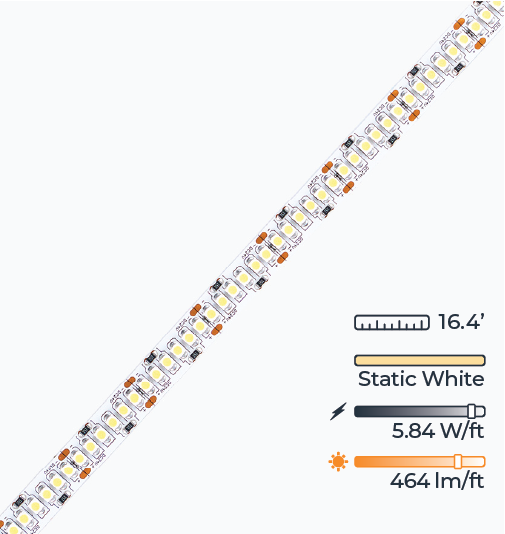

I have 20 LEDs per ft. It's plenty bright for my needs.
These high density tapes offer 464 lumens per foot if you need it. This type offers 72 LEDs per ft.
There are also dot-less types available. They are water resistant so you should be able to clean them.
