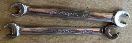

11mm for me, which annoyingly is missing from this otherwise decent-enough inexpensive Pittsburg crows-foot flare-nut set...
11mm is however included in this also inexpensive but otherwise decent SEDY flare nut set. Bottom right, in the EZ-red magnetic holder (which ironically costs more than the flare nut wrench set)
I have lots of other high end wrenches, and an older set of Snap-On flare nut wrenches in SAE (which never use), but by definition, I'm using a flare nut wrench on a fragile fastener where the primary goal is to prevent stripping, and they almost never require big amounts of torque where wrench failure might even be a possibility, so I am ok with cheaper versions of these specialty tools... I guess if i was working on heavy equipment hydraulics in large sizes it would be another story...

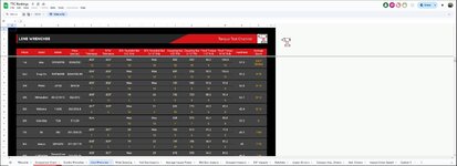

Mac USA are every bit as good (and even slightly better according to TTC's testing). Having metrics in Snap On and SAE in Mac, both are every bit as good as each other.
