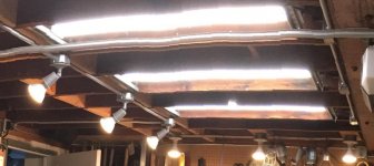

I also have a deck over the garage roof and want to keep open rafters to monitor for possible future leaks.
I recessed Costco LED shop lights into the open spaces by supporting them with short lengths of metal super strut and lightweight L brackets.
I ran a row of receptacles with EMT. The floodlights are to light up a wall of open shelving.
My ceiling height is even worse...just 7 feet
If you go this route, painting the ceiling white won’t make any difference. In my opinion, rough wood painted white and then getting dirty looks worse than bare wood.
So one vote paint it white, one keep it wood!
Thanks for the photos, that is a LOT of flood lights!!!
Did you do anything to reduce summer heat/winter cold on the ceiling??

Paint will help, but once you paint it, you'll see all the sawdust and dirt, and you can't go back. I don't knownif i would want to have to clean and maintain that.
That’s why I keep my garage unpainted rafters and wall studs. BTW, my floor is bare 70 year old steel troweled concrete.
The climate here is very mild and I don’t need heat or AC. If I lived elsewhere, I’d probably have insulation and drywall.
As far as the overhead lighting goes, with LEDs, the light is directed downwards and not emitted 360 degrees like a fluorescent tube. So the white ceiling that helps with fluorescents is not as important when using a directed source of light like LED tubes.
In that case a white floor would really bounce extra light around but not very many of us would want to maintain a white floor. :)

I think I might try adding the lighting first, then decide later if I need to paint...
Good plan
In the picture of my installation, I placed one fixture in every other ceiling joist cavity so they are 32 inches apart. Lots of light even with dirty dark gray floors and no paint anywhere. Those fixtures are only $25 each at Costco so lots of fixtures spread out over your low ceiling is the way to go.
