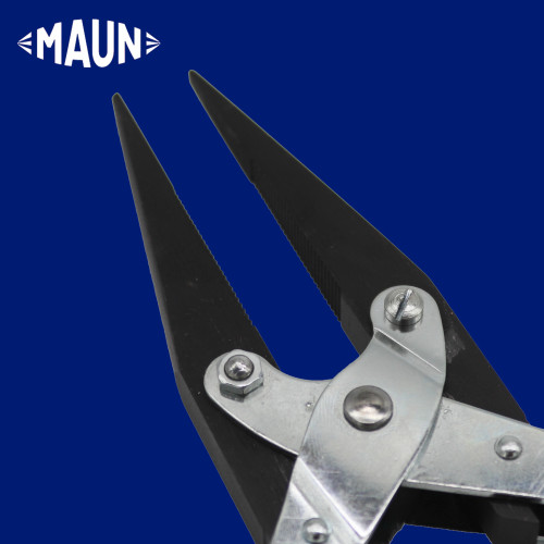

Maximum jaw opening 13mm in size 200mm, or 10mm in size 160mm - so quite limited.
Also note it's a long/needle nose rather than a flat or duckbill nose.

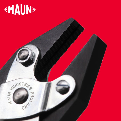

Regular Maun parallel jaw pliers have a wider jaw.
The jaw width varies with the length.
The jaw width on the 200mm size is listed as 12.5mm.
200mm is usually the metric conversion for an 8 inch length plier, and 12.5mm is basically 1/2 inch.
The opening is listed as 17mm on the 200mm size.
The 200mm long nose plier, is a version of the 160mm regular plier, just with longer pointier jaws.
The 13mm opening is also basically 1/2 inch.
This is a new plier design for Maun released within the past year or so.
