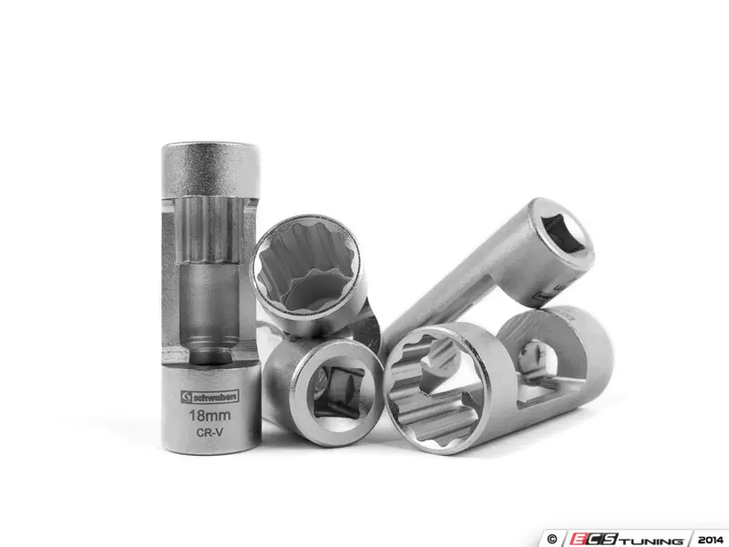

Well, it looks like what I need
But I guess we shall see about the quality. Not so good, if we go by the description on the label.
"18-piece special tool set for the five-corner sleeve of the saucer-type sub-pump"
Did it arrive yet? I’m curious how the quality is.
Toold_up
Feb 9, 2019
640
Attached
It looks like those sockets have flats that you could possibly get a wrench on too. (y)

Well, now for my review.....
This set worked well for the nut on the front strut mount, except I needed to use a 1/4 drive extension & socket for the strut rod. They didn't have a large enough center socket part. Also used it for the sway bar link.
In the rear, I still need to buy crows foot wrenches to make sure I have the rear right enough. The plastic trim didn't allow me to use the spanner on the 18 mm socket....too deep.
What I learned on this mission is that I should consider just paying a shop to do the work.....
Buggered the threads on one of the strut mount studs & one nut. Luckily I have my trusty HF tap & die kit...
Getting the rear upper bushings pushed into the hole far enough to get the nut to start threading in....
As mentioned above, had to use a box end wrench on the fancy socket to tighten the top bolts.
Getting the front strut mount bolts tight enough using a ratcheting wrench, because a regular socket was too shallow and a deep socket wouldn't fit under the cowl.
And I found a push pin in the sidewall, that leaked when I pulled it out. So now I need to find a new tire too.
On the bright side, the motorcraft front struts came with the boot & bellows, so I can return the 2 boot kits for a refund! $36 - $8 shipping...

Anyone know if these Chinese strut nut sockets are any good? Are the Schwaben ones better or are they all the same? There's also another set on Amazon by Laser but they're really expensive. I just changed a coil spring on my Golf and I want to be able to torque the strut nuts to the correct spec.
M635_Guy
Dec 5, 2019
4,352
NC
I have the Schwaben set (which is almost certainly just a re-label) and they're fine. For essentially the same money, I'd get that one just to have a (relatively) more accessible company to deal with in the unlikely event you need support. I doubt there's any real-world difference between them - these are not tools that see a lot of stress.
s45
Aug 27, 2023
81
Toronto
Thanks, I ordered the Chinese ones. Was going to order the Schwabens but I am in Canada and I don't know how much duties would cost.
