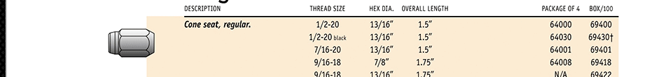

I need to replace the spare tire mounting hardware on my utility trailer, as it has gotten corroded. I would like to replace it with stainless hardware consisting of :
1/2"-20 x 1-3/4" all stainless carriage bolt
retaining ring
1/2"-20 stainless tapered lug nut
I've seen this hardware kit sold as a zinc-plated kit from various sellers, but not in stainless. I would even buy the hardware separately, but as for the carriage bolt, it seems to be only available as a 1/2"-13 (coarse thread) in stainless.
Anyone have a good hardware source for this? - Thanks

That's a standard thread pitch for lug bolts. The original carriage bolt/lug nut combination is 20 tpi, but the bolt size and lug nut on this spare tire rack is odd ball (probably metric). I'm just trying to make the spare tire nut the same size as the road lug nuts so I can remove it using the same 13/16" lug nut wrench, while also making it rust free. Presently, the existing lug nut on the spare is 3/4".
12/16 is close enough that the 13/16 wrench should take it off. It's not like it's torqued to 150ftlbs

I've replaced my share of wheel studs that were getting too rusty for my taste. But I totally agree that I'd be using a lug nut here. I'll take it one step further and even suggest using a wheel stud instead of a carriage bolt.
How would you suggest mounting the wheel studs? Drilling holes in the plate and drawing them in with an impact wrench? That sounds good to me.
If you're installing this in a new hole, yes. The benefit here is that it's easier to drill a round hole (assuming you have the right size bit) for a stud than a square hole for a carriage bolt, and the stud (especially if you bed it in some red loctite) should hold well enough for your purposes to make mounting the tire a little bit easier too.
If you're expanding a square hole from a carriage bolt to take the stud, that might be difficult. I'd probably attack it with a round file, or maybe a step drill bit.

If the hole is square, put the stud in and tack weld the backside.
This is how I had my old tire rack setup.
Thanks, I'll probably go this route with tacking, since the existing holes are already there. It's not like it's supporting the weight of the trailer. Only the spare.
I don't have the 1/2" studs yet, but I'll do a test fit tomorrow when I get them. I'm thinking the square hole is exactly 1/2", so loctite and a hammer will probably get the job done. I do have a round file just in case. Thanks again.
