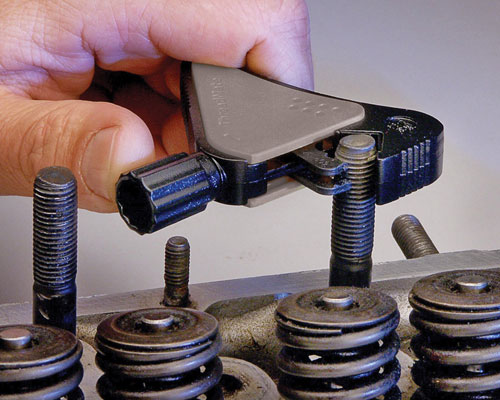

Have you considered "thread files"
These little jewels have saved the day more than once. They are relatively inexpensive and very handy. They are available in metric, pipe and English pitches.

The idea with a rethreading tap/die (chaser) is that the very edge of the cutting surface is blunted. It can scrap foreign **** like rust or loctite out of the threads, it can take smashed-over threads and push them back up where they belong, but it can't cut metal away. So it's closer to a thread re-former than a thread re-cutter. In reality, it does like 80% reforming and about 20% cutting.

Yeah, if there's basically no undamaged threads left in their original location, a thread chaser/rethreader can't help. They're for when you have clogged threads, smashed threads, or a foreign object was drug through the threads by the fastener and ripped the hell out of everything, etc. Things were the root of the thread is intact.
Then again, given that everything I do is automotive, for safety's sake, if a thread chaser/rethreader can't restore the thread to the point it'll hold the torque spec, it's time to start from scratch. I don't ever try to retap at the same size even if there's a fair amount of undamaged threads.
