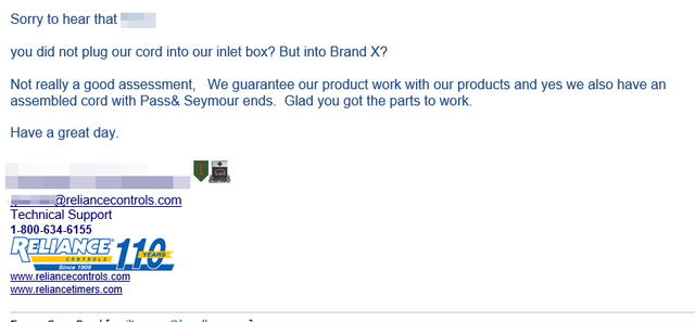

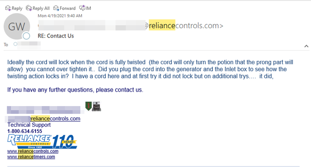

Responce from Reliance, and Amazon wouldn't post my review... Now I know why the cord has such good reviews

yeah there was something wrong with the first one. prong probably hitting the tangs

I've complained, they are reviewing why it was not posted. I'm sure I'll get some generic boilerplate response
I replied to Reliance saying that my new cord works fine, and their cord was the issue. This is their reponse
I guess NEMA 14-30R or NEMA 14-30P aren't standard electrical connectors :dunno:
I pointed out I was plugging their cord into their own cord, so...

That company is full of ****... I have different brands of L14-30P and Rs they are locking fine. even the ones that came with my Generator locks fine with others.
