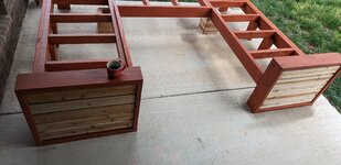

I wanted to coat as much of the wood as possible, so I started by cutting the material lengths I knew and staining the individual pieces. Not the best results, but I've got a sander, so no big deal.
At this point it was either burning a day waiting for stain to dry or get the frame assembled and deal with the stain later.
I opted to get the frame assembled.

The legs are fitted and the frame is stained. It ain't perfect and it's a whole lot of time to paint every surface, but I'm satisfied with the results thus far.
Got some of the slats stained too.

Back slats installed on the two short sides. I've still got the long side to cut, sand and stain.
I've also got a lot more sanding and staining on what you're looking at before I'm satisfied with it. I'm clearly not a painter, the back slats turned out a little better than the previous stuff, but I've still got runs. Guess I should have watched some tutorials before I started.. lol.
WoodsTruck
Jan 12, 2013
1,040
I think it would be easier to keep the cobwebs cleaned out as is.
Looks pretty good.
