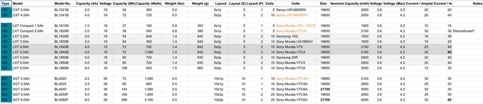

The stock 5.0 Ah battery uses either 10 cells of Samsung 25Rs or 10 cells of Sony Murata VTC5 in a 5S2P configuration. It looks like the battery pack can output a maximum 0f 40 A.

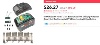

The aftermarket has some casings that accept 15 21700 cells. There's also the 5S2P cases that I think you used.

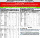

Looking at the table from Mooch... he didn't really test 15 A draws. Likely because it's not a common output current draw for 21700s. I guess I could look at 10 A tests, the LXT 6.0 Ah only outputs 30 A, so maybe I'll be ok. Samsung 50S would be best for me, and give me an E-score of 13.7*3 or 41.1. They also have the highest rating at 20 A of 11.4

So looking at 18650 cells
In a 5S4P configuration, if my goal is 40 A, 40/4 is 10 A. The highest rated 10 A cell is
Molicell P28B, Molicell P30B OR Murata VTC6. Of these cells Murata VTC6 would likely be the best. Giving me an E score of 8.0*4 or 32.
So it looks like 15 21700 cells is the winner and Samsung 50S. I'm not sure if I did this right?

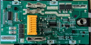

I think this is the original BMS board from a genuine Makita battery.. They seem to cover the whole board in some sort of epoxy resin.
The BMS board from the Amazon knock off from your project.
The ones from Ali knockoff for 5S3P. They do look a bit different!
I can't find the case only with the BMS you have in your battery that you got off Amazon.
That's conformal coating, it's there to protect the board from corrosion, but Makita lays it on extra thick. If you look at the board from the battery I built, it has some as well. The board from the kit you were looking at doesn't have any at all.
Copy and paste this link into your browser:
Clicking won't work, the forum breaks the link.
