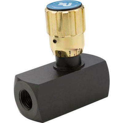

Alright folks, I come seeking hydraulic knowledge. I bought a used MaxJax (because I already had the mounting/bases for the old one) cleaned it up added new quick disconnect fittings, bled the thing and it lifts uneven... like they all do.
I had this problem with my last one and would lift to the first hole, lower, and left again for a full height lift. Same on the way down since it never worked right... but it was in spec, lol.
This one is just out of spec and the higher ram is ~1.75" above the other at the first hole (~1.5" is spec... so not bad). The problem follows the hose, which means its probably the flow divider / combiner.
I've read people trying this control valve and also just replacing the flow divider with something like this but I've never heard if it fixes the problem or will cause more problems with other parts.
I realize I can buy one from Maxjax, but at $300 (cost+tax+shipping) its more expensive than just about anything else out there (given the specs listed on the maxjax site). This is surely the easy button, but given I've had problems with 2 lifts now I wouldn't be shocked if this part makes the problem better, but doesn't fix it.
So I'd love to hear from anyone that has replaced parts on their maxjax with aftermarket, or anyone that knows about hydraulics...
Thanks guys!

the flow divider linked in the OP says min inlet flow 8gpm; max inlet flow 16gpm....
the maxjax one says max inlet 3.5gpm

i'm thinking about putting https://www.amazon.ca/dp/B0000AX3M1/?tag=atomicindus04-20 on the faster side....
well that item fixed it. I also needed a 3/8NPT male/male adapter, and a union of sorts if your fast side is on the same side as the input to the flow divider. It took a couple of short lifts with the arms unloaded to get the arms to be close to each other , and then I put the miata up on it. I got the arms to be within an inch of each other at the top with a couple minor adjustments.
I need to the put Golf up on it next to do the oil change... Don't know if i will need to adjust it further for different weights of vehicles.

lifted the 2015 Golf TDI - curb weight ~ 3100lbs. Reached the top rung within 0.5" of each other without needing to adjust the valve further.
The Miata probably weighs about 2300 lbs.
Will be interested to see how the lift does in terms of evenness when the q7 goes up (over 5000lbs), or the riding mower 600lbs for changing the blades.

Coming back here, because it seems like I have to adjust the valve occassionally to even out the the lift arms.
We've added 2 EV's (~5000 lbs) to the stable, and it does seem to make a difference between lifting them vs the VW Golf or NB Miata. I may look at an aftermarket flow divider with a lower flow rating to solve the uneven issue.
My latest research seems to be pointing to the fact that the maxjax flow valve is rated for a lot higher flow than what is needed, and the 'flow-by' (like blow-by for oil consumption) in the valve is too much for the volume that is actually moving in the system....
According to the interwebs, the maxjax requires 7 quarts of Fluid, and takes about 50-60 seconds to go from the floor to max height, so that's right around 2GPM flow. The maxjax replacement flow valves are 3.5GPM
