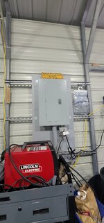

Background: I live in CT where it's a mixed climate leaning more towards cold and fairly high humidity. I bought a house with an existing 25x25 metal 2.25-inch steel tube frame building. The walls are 10 feet tall, the peak of the roof is 14 feet, has 2 8x9 ft doors, and has a 1 ft cement foundation above the slab. I have epoxyed the floor and installed a 100 amp sub panel. Extension cords are temporary as I am waiting on inspection of the panel.
I plan on working on my classic car, my daily and my wife's car, while also using it as an occasional hangout place if it's too cold to be in the yard.
I will be installing a 12 or 18k mini-split unit and a ceiling fan for air circulation. I plan to keep the building above 45-50F at all times(storing sensitive paint, aerosols, 50+ year old car parts, tools, and welder) and around 65F while I'm in there working. I would like to put wall-hung cabinets above my workbench, as well as things mounted throughout the walls.
My plan so far: I have sealed up all openings in the building with caulk, stainless steel wool(for pests), and breathable foam (https://www.wildlifecontrolsupplies.com/animal/B3X-SR-24.html) for the roof ends. I have started putting up a vapor barrier with a 1/2-inch air gap between the studs(see photos).

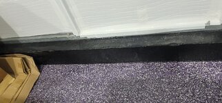

2.) Since I have a ~1 foot footing above the floor am I ok to put OSB/plywood in contact with the epoxy-covered cement? (Moisture issues) Or should I put a 1/2-3/4 inch gap?
--- I wanted to put the walls in contact with the footing to distribute the weight of the walls to the floor.
