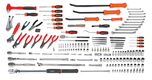

https://sep.snapon.com/webclient/index.html#/product/SEPPREMET
This would fit nice in the trunk :thumbup:
(Just make sure to get it insured :eyecrazy::lol::lol:).

Alternatively, for $0.10 on the dollar, ou can simply duplicate those parts lists, and store the tools it in some small toolbags without much hassle.

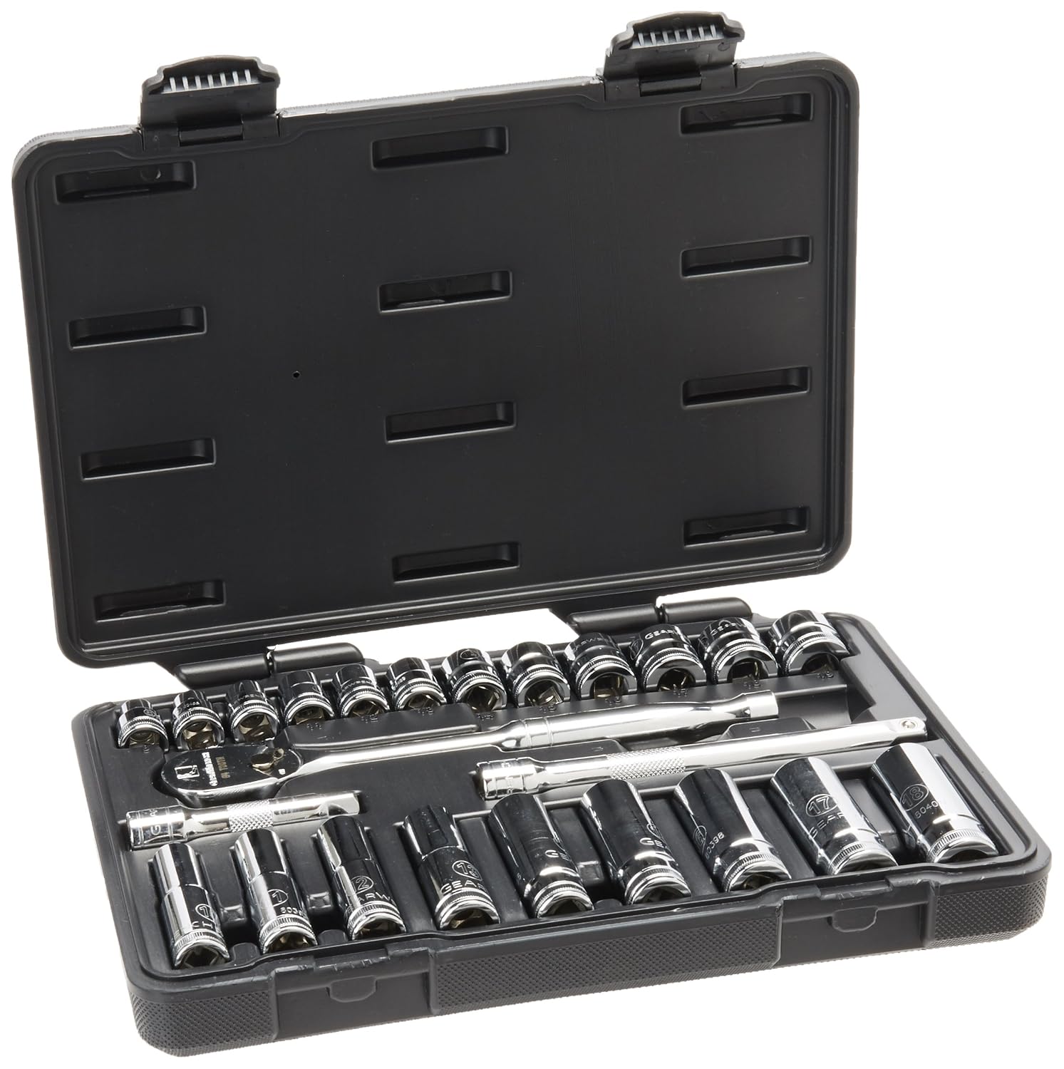

So Needed a 3/8 set. I didn't want to pay Snap On or even Blue Point prices. I needed both Metric and SAE and got the 57 piece KD Gearwrench set. Couldn't be happier. So I went looking for Metric only for you. It's a little harder but Gearwrench has a 3/8 set in Metric only.
That set has both deep and short size sockets in metric only. Gearwrench is made by KD Tools. They have been around for a long time and are quality tools.

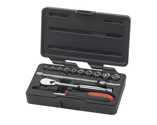

I found a short metric sizes set only in 1/4 drive.
Add a socket rail with the 1/4 deep sockets and you are covered for both 3/8 and 1/4 demands.

I recommend the KD Gearwrench tools to you for good quality at lower prices. You can always get better quality but it gets very expensive as you prolly know.
Whatever you do get these two sets in some sort of a fitted box. I mean by any other brand even. Having the tools in a fitted box is time saving and lost tools saving because you will never leave a stray tool on the ground or inside the fender if you are the least bit neat about picking up after working on you cars.
BTW, these sets are easy to find on Amazon.
The people at snap on have to be very drunk and a whole lot of stoned to think that set is worth that much, I'd have to be stoned to consider buying it and I'd understand my wife leaving me over it. Looks like it could be duplicated in wright or SK for less then half the price.
Have any info on the second set, it looks like it was designed to be tossed in the trunk, though the Allen keys look a little cheesy being chromed. If its real cheap buying it for the box could be worth it.
