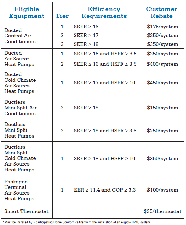

I have 2 multi head systems that heat and cool.
7 total indoor heads and 2 outdoor units.
They are ahri certified to 21 seer/hspf 11.0 and I have received significant rebates from ComEd for each system.
I am very happy with my energy efficient multi head systems that I installed.
