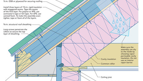

Thanks. i think I'll go with the wall unit AC and a portable heater. What about insulating the ceiling? I've got 2x4 rafters so not much room, and no vents currently. Can I do a hot installation or do I need venting between the ceiling installation and the roof underlayment?

Is the ceiling open to the rafters/trusses? If so, I'd consider a ceiling to hold insulation and separate the working space from the "attic". Add a couple vents in the soffit and then either in the gables or along the ridge

If you could fur the ceiling out to fit r19, that would help a lot if the roof will have sun exposure. The use fiberglass Batts
Is the roof already complete? If it isn't shingles, adding a layer of foam board on top would help too

I could do that. Roof is already complete (I'm retrofitting this thing...it's old) and it gets a lot of direct sun exposure. Do I have to fur out enough to create an inch or so of an air gap between the insulation and the roof underlayment?

I imagine it has A frame rafters, no collar ties on that small of a building. I would leave air space under the roof, best if you could ventilate it, perhaps simply add a ridge vent.
As for insulation, you could attach rigid foam board across the rafters, then screw sheet rock over the foam board. Use good stuff, like Owens Corning Foamular 2" will give you an R10, good enough for that small shed.

I would tear off the shingles put felt down on the plywood, install about 3” thick rigid poly iso roof insulation and another layer of plywood and a new roof. If you are careful the screws will go into the existing roof rafters and you will not loose any height and gain about R30

Try researching a "hot roof". You don't necessarily have to vent the underside, but the details matter.

Thanks everyone - great advice. Quickfarms, I do like the idea of redoing the roof as you're suggesting. With that approach though, I'll have no venting at the top, right?
