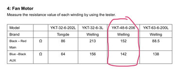

but also… I wanted to share this I just found on a service manual which indicates the right Ohms values for red - black and blue - black. I think mine are off..

So I connected the red and black Fan Motor cables directly to 240VAC. It didn’t turn ON.
Weird thing is… now black and red ohms changed from 30 M ohms to 13.3 M ohms. Si did Blue and Black…
