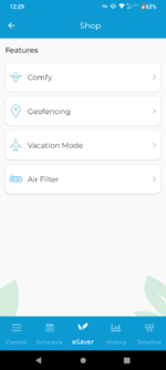

MrCool has the FP (freeze protect) setting which is 45 degrees.
How do you turn that on? I've long lost the manual but would love to heat to "not freezing" instead of 60. Doesn't get cold often here, I just want my water-filled engines not to die for the few nights it dips below freezing.
My Old Tools
Jun 4, 2014
5,468
Hamrick Lake, TX
In the phone app, it is a pull up on the heat page that says FP. On the remote it's a button that says FP.

Mr.Cool also has a "Comfy" setting under "eSaver" that lets you set a range down to 40F. I have mine bounce between 45-55F when I'm not in the shop.
