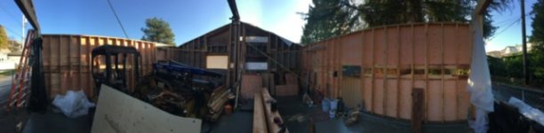

Slowly but surely making progress, got 4 walls up and sheathed, structural steel in for the roof and now onto beam packing and cutting rafters.
