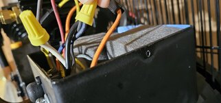

Well, I'm officially stumped. I previously posted about my Kobalt 80 gallon compressor dying on me. It seems like a relatively simple device. I tested the switch and it is working properly. Power is coming through it as it should. I even bypassed the switch in my initial testing with the original motor. It's getting power to the motor, but the motor doesn't even attempt to spin. I can spin the pulley for the pump easily by hand, so the pump isn't locked up. The capacitors also tested good with my meter. So I assumed it had to be something inside the motor.

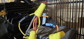

Well, I bought a new WEG motor which came with new capacitors and I got it installed tonight. I can't get this one to run either. It's like it's just completely dead, just like the old one. I've tried the thermal reset on both and that's not the issue. I wired it like it says on the sticker on the side and I've included pictures so that you all can double check to make sure I'm wiring it as it says. I hooked the blue and black wire to the hot black line. I hooked the yellow wire to the hot white leg. I hooked the brown wire to the red which is what the diagram seems to indicate. Then I hooked the green ground wire to the green screw at the bottom of the wire box (if that's what you call it) on the motor. Both the white and black hot wires are showing 122.8 volts on my meter where they connect to the corresponding wires on the motor. I just can't figure out why it won't even attempt to spin.
Any advice on where to go from here? I'm completely lost.

The motor does not care if you have 120 volts. The motor needs 240 volts between line 1 and line 2.
You need to test between the two hot wires. Testing voltage to ground does not tell you anything useful.

So when you're saying check it across the white and black hot wires instead of to ground, are you just leaving the meter in volt mode and putting one lead to each hot wire?

yes, measure voltage between both hot leads
Looks like I'm getting 9-10 volts coming into the hot wires at the switch when I'm doing that. So now I'm thinking it's got to be the breaker or the disconnect now. I'm going to pull the panel cover off and check at the breaker now.

Thanks guys! I found the problem and I feel really dumb that I didn't identify this at the beginning. I just thought the motor was getting power since my non contact voltage tester was showing power, then the meter was if I checked each leg to ground. Turns out I wasn't getting power on both legs.
I started checking at the breaker and had 244.8v there. I moved to the disconnect box and had the correct voltage going in, but not coming out. I pulled the cover off and discovered there was a fuse on each leg and one was blown. It's been long enough since I put the disconnect box in that I forgot it was fused. I swapped this out and I'm back in business.
