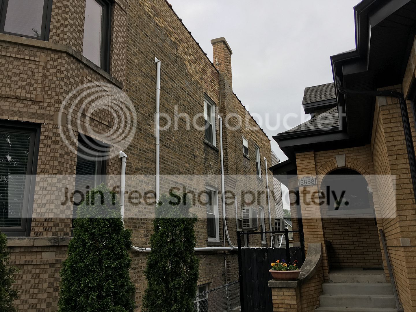

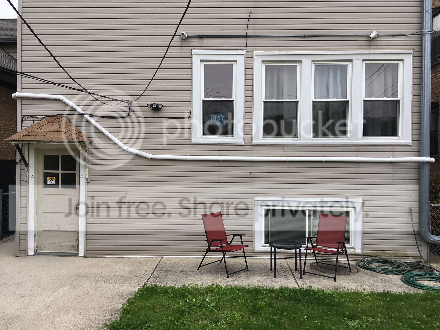

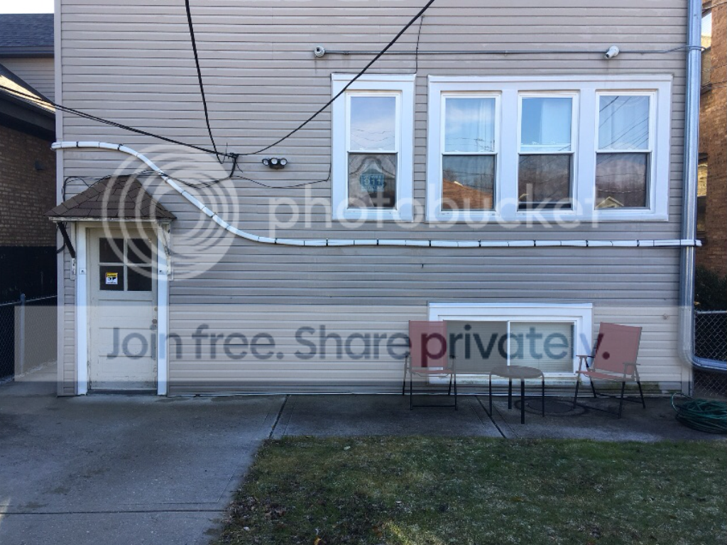

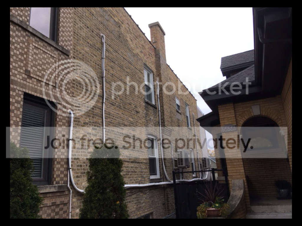

Some updates...
Units are running good so far so decided to start the lineset cover project.
I tested a couple different lineset cover options and decided what's best for me. I'm interested in future accessibility, uv, and minor/medium impact resistance. So I ultimately decided on outdoor rated insulation jacketing.
This is an ongoing project (which is not complete yet) but so far I'm happy and the wife likes it also.
Before:
After:
Before:
After:
aunsafe2015
Apr 2, 2016
436
Northern VA
Some updates...
Before:
After:
Before:
After:
How did winter performance end up being? Did you use exclusively mini split heating or did you have to resort to oil/gas on cold days?

SALIV8
Dec 11, 2008
2,114
chicago and s/w michigan
Winter performance was awesome down to 26-28* F sustained outdoor temps. Much colder than that we needed the radiators for our preferred indoor temps of about 70*
I sized the systems for cooling, however, we enjoyed the slight oversizing for the winter and shoulder months which saved us good money on the gas bills.
Very happy with the systems so far. Hopefully they last many years.
