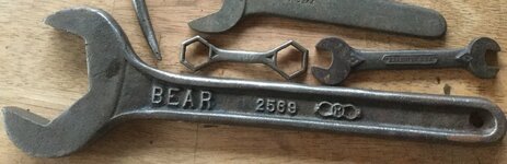

Not a clue and I have yet to figure out WHO this particular "Bear" was.
(note that @3baygarage's specimen sports the same part number and logo.)
(it is NOT the same as "BearGRIP" from the Netherlands)

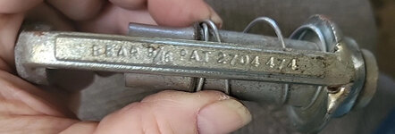

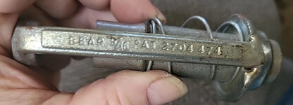

There is a patent for a tie rod adjusting tool with a similar BEAR logo.
The patent number on that tie rod tool is assigned to the Bear Manufacturing Company, Rock Island, Ill., a corporation of Delaware Application September 22, 1953, Serial No. 381,657
So I'm guessing the wrench is a tool for use with Bear automotive maintenence equipment.
28,953
I think what you are seeing as "LOGO" is actually "9/16"

That wrench is too short to be adequate to tighten a bolt that size in a engine or building construction so it must be for something that needs to be snug but not torqued , which a brake lathe would be a typical use.

Assuming this is Bear Automotive: I have a lot of Bear info, but nothing that old.
Bear started in 1917 and made all sorts of equipment and tools in the early days, mostly to do with suspension service and wheel alignment. It could also have been a tool for their own equipment.
