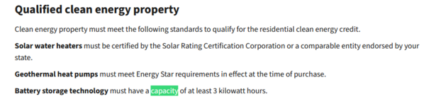

are you trying to make a system that is eligible for tax credits?
If so make sure you include batteries that are over 3KW.
I’m not familiar with this. do you have any more detail? Single battery? Or the whole bank?
Why? Is there an IRS limit on batteries that are under 3kW? I write off every battery I add the house, every year. I write of solar power to the gate. It's all compliant and in-service.
The trick is that the IRS credit is focused at "primary home". If this is a structure somewhere, it may get a little messy:
"You may be able to claim a credit for certain improvements made to a second home located in the United States that you live in part-time and don't rent to others."
