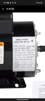

That is maybe a 2hp motor. A real 3hp motor would be rated for 25-30 amps on 120v, and for that reason, they don’t really exist.
Regardless, I’m surprised it taps out that fast. It’s certainly not a heavy duty unit, but I bet something’s wrong with it aka faulty. Put an amp clamp on it to confirm.
I'm thinking try slightly smaller pully and throw and amp clamp on as next step.

There are two things going on here:
1) The motor you bought is not actually 3HP
2) Your old motor is also not 3HP
At 17.2A FLA @ 230v, your old motor is about 4HP. I suspect it's actually "3.7 HP", as that is a very common rating for newer compressors,. Your new motor, with a 9A FLA @ 230v is going to be around 2HP at most. Just seeing that it consumes half the amps should be a clue that it's got about half the power.
You're going to need to drop the pulley size down dramatically for this to work, unfortunately.

The other motor was not dual voltage. I moved and no longer have 220v. I tried to run 220v motor on generator and blew the motor. Threw a 120v motor on to use at current house.
Yeah so if it was 17fla @ 240v then your new motor is half as powerful. You will need to cut whatever size pulley you have on the motor in half, which might lead to not having enough grip or even if you do not spinning the pump fast enough. Worth a shot if it's all you got though

Very helpful guys. Using the pulley calculator posted above. I should be able to switch to a 2.5 inch pulley from a 4inch and still have the pump spinning fast enough. I will give it a try and throw on an amp meter as well and report back.

Thank all of you for the help.
I would like to report that after changing the pulley to a smaller size and getting a smaller belt the air compressor runs perfect.
Builds to 135psi, kicks back on at 90
13.5 Amp draw at peak power and runs super smooth and quiet.
Success!
