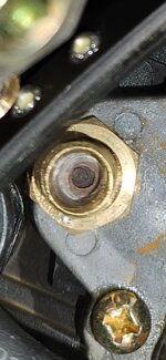

This is what the inside of that unloader inlet looks like (bottom of the mirror). Is that OK, or should that needle be poking up and through a bit more?

The check valve can be tested by disconnecting it from then pressure switch, holding your thumb on the end, start the compressor let it build pressure for a bit, stop the compressor and release your thumb. You should get a small amount of air out of the tube. If the tube continues to bleed air, and the tank pressure goes down, the check valve is bad.
The small valve on the pressure switch is supposed to close when the compressor is running and open when it stops thus relieving the pressure from the check valve to the compressor discharge.
This is because the compressor will start easier if there's no pressure in the line.

as said, the unloader stops air from escaping when the pressure is building, when the pressure switch is satisfied and the compressor shuts down, the unloader opens and lets the air bleed off from the check valve to the compressor so it's now at atmospheric pressure , allowing it to start with no load on it.
it sounds like you have diagnosed a bad unloader valve . I would still like to see a picture of the unloader valve at the pressure switch .particularily where the pin is at the tang on the switch to open it up .

That is exactly what is happening: I can plug the end of the copper tube and the tank builds pressure easily and I stop it and release the hold on the tube, there's only that tiny puff of air, but the tank easily holds pressure with no leaks.
So yes, it is the unloader valve.
Is the inlet to that valve supposed to look like this?
The orifice looks very irregular and the pin does not seems centered there.

can't really tell for sure, but it looks like there's some rusting inside there. which would make sense why it's leaking .
is that the tube side with the tube removed or is the tube on the other side?

That's the tube side with tube removed, so it's the unloader valve inlet coming from the check valve.

In this circled area? There's space there

show me the other side of the picture in post #12
That is the area circled in the picture in post #17.
There is no pin in that circled area.
I can push the "plunger" From the inlet side (the middle of picture in #12) and I can see a pin come up into the space circled in #17.
