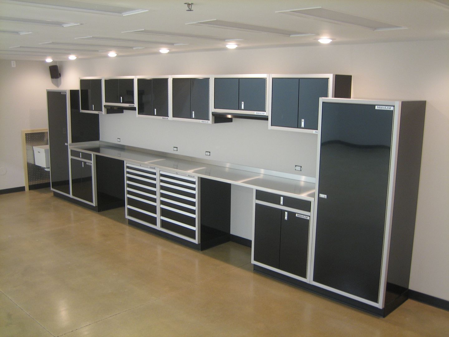

In my opinion, you'll need T8's or T5's for working on projects without supplemental (directed) light.
We used 16 cans on the perimeter of a 16' x 30' space under our mezzanine and an additional 19 two bulb Troffer lights.
Home Depot - 2 Bulb 4' Troffer
The cans do a 'decent' job of filling in the gap between the T8's used under the mezzanine and the four bulb T5 fixtures in the 18' high bay. Likewise, they provide some fill in light above the cabinets in our setup. IMO, even if there were another 20 cans in the center in lieu of the T8's, the lighting type/volume would not be sufficient if you're going to be doing detail work on your cars/bikes.
Could you do it? sure, but I think you'll be squinting from time to time.
Now, to be fair, I have not attempted to crank up the lumen value of the cans or played with lighting temps, but I have seen similar spaces to mine with cans only and I would call the lighting only 'sufficient' for general use.
I'm very spoiled by the lighting we put in our place, but I've turned off 1/2 of the T8's under the mezzanine, and to my eyes, it's still not enough.
Nobody has ever said, 'you have too much light' to me.
Original 'all-can' plan layout below:
Pretty much the final layout/plan:
Cans only on top - all on the bottom (sh*tty cell phone pics)
'In-Use' pic:

HIRISC - that is a sweet looking shop!
What did you use to seal/stain the concrete floor? Any problem with the jacks digging in into it?
HIRISC
Jun 9, 2006
828
Minneapolis, MN
Hi Scott,
Thanks much.
It's MMA (not the fighting kind) aka Methacrylate. Basically a fast drying acrylic.
Re durability - my short answer is that it's pretty durable to everyday wear/tear like driving your car over it. It also handles carefully handled floor jacks OK (though I now put cardboard down first), but you can't be careless with MMA.. the acrylic is more brittle than epoxy or quartz. If you drop sharp/heavy objects on it, it will put little marks in the floor. I've had to learn to work with that in mind.
The good news is that if you mark/scratch it up too much, you can pretty easily have another coat of MMA put down over the first one.
All flooring surfaces are a trade off (unless you're smart and just leave plain concrete alone). We wanted the 'exposed aggregate look', and since you can't see 'through' epoxy or quartz, we went with MMA.
