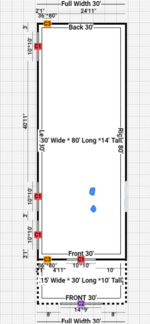

My building is coming up on the concrete stage. Going with a 4in slab w/ footers. I want to locate the 2 post lift so those spots can be dug out for thicker concrete.
The far 10x10 door will be moved to mirror the left 10x10 (currently middle in image)
I'm thinking that bay makes most sense, but want opinions.
Thanks,Greg

From what I can research, looks like the usual recomendation is 10 feet away from the wall. So Im thinking (2) 2x2x12 spots for the lift pilars around 10 feet apart.
Any thoughts?

That's 20' in from the door, if I understand your 10' from the wall correctly. Unless you have really long vehicles on an asymmetric lift that seems so far in that you'll have a lot of wasted space behind the vehicle, and it will be crowded in the front as the vehicle may take a good part of that 100'. For example a Chevy 2500HD regular bed is about 250" long and the CG is about 100" from the front. If you put that on a lift where the CG is centered on the lift and the lift is 10' from the far wall, the truck takes up 8.3' of that 10'.
Maybe you're working on smaller vehicles but it still seems crowded especially if you want some workbench or toolbox space in front of the vehicle.
150" is 12.5' so I'm currently planning on centering my lift 15' in from the door, in a 40' deep building.

I put mine as close to the overhead as I could. That way I could leave stuff in front of the lift and not have to move it to use the lift. I have a crew cab long box, and I can just walk behind the truck when it's on the lift, door closed and trailer hitch installed. I wouldn't do it any different now that I've done it that way.

Agree 100% with the above statement. My crewmax Tundra is the longest vehicle I have, and I set my lift up the same way. Then you have far more room in the front where it’s needed.

As promised: center of post to garage door= 12’ 3 1/2”. That leaves me with 18” behind the truck to the garage door if the receiver is not installed in the hitch. The center of the post to the front of the truck is: 8’ 3”. I have a long cabinet in front of the truck and that only leaves me 26 1/2” between the truck and the cabinet when on the lift. Hope this helps you. REMEMBER: I have the 5 1/2’ bed NOT the 6 1/2’ like you.

Yep, fully understood and thanks for the reply. My building is 32' deep so I can give up some space in front of the truck, but I'd like to keep that to a minimum for other reasons. I'm thinking I may go 14' from the door to the posts. That should give me at least 5' - 6' in front of the longest trucks and walking room behind.

Sorry for the late response. I have a symmetrical lift. Measurement from the garage door to the center of the post is 14'2". Center of post to the front bumper is approx 9'6", but this can change as the truck isn't always in the exact same spot every time. My overhead door is 14 ft high.

Another random input of a guy having used a 2 post lift at work for 22 years so far. Work bench is only a few feet away on one side, and a row of welders a few feet away on the other side. Has not been an issue at all. No way is 10' needed on each side of it.
