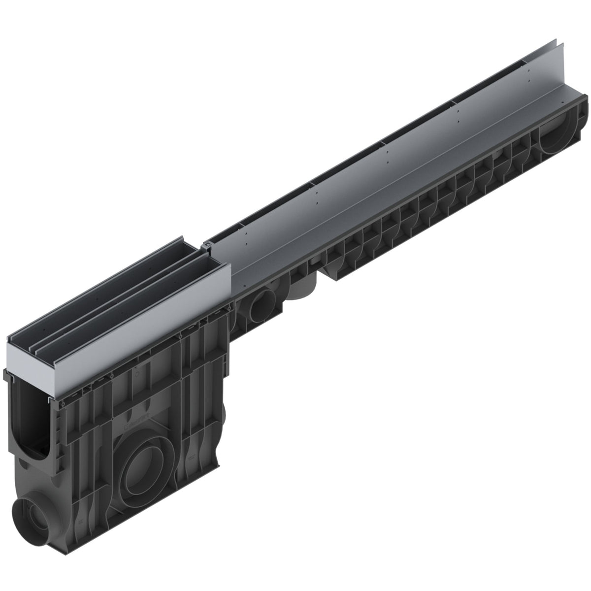

All good info here... For drain selection.. anyone have favorites? I will admit, I looked at this brand:
But it's a bit pricey since I would have to have two systems.
