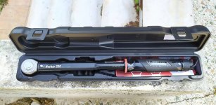

Hi, I am in the market for a couple of Norbar torque click type wrenches in the lower end of the torques scale such as around 1-60 nm or so.
They are both available in 3/8, one is not sold in the US but available in the UK it is the TTI 20 13640, this one goes from 1-20 nm. The other one is the 13010 and it goes from 8-60 nm. I like the fact that they have a tolerance of +or-3% vs. the usual standard of 4% and they are within my budget.
Is there anyone here that owns this brand or have these wrenches that can comment on them or does anyone own something similar they can suggest in either 3/8 or 1/4. I prefer the 3/8 since the majority of my sockets are 3/8 but would be open to 1/4 drive also.
Thanks :)
I've got two 3/8" drive Norbar's in those ranges (at least 25 years old, the smallest of which is a non ratcheting fixed head) and I've had a couple of 1/2" drive up to 350nm issued by my employer.
You won't find better for the money, they have pretty much dominated the pro Torque Wrench market in the UK for decades (hence the Snap-on buy out).
They tend to use plastics in the handles a lot compared to USA brands, but don't let that put you off, they are very robust, they also supplied other UK tool brands like Sykes Pickavant with rebadged versions.
Solid reliable kit and very easy to read with magnifying windows for the scale on most models 👍
