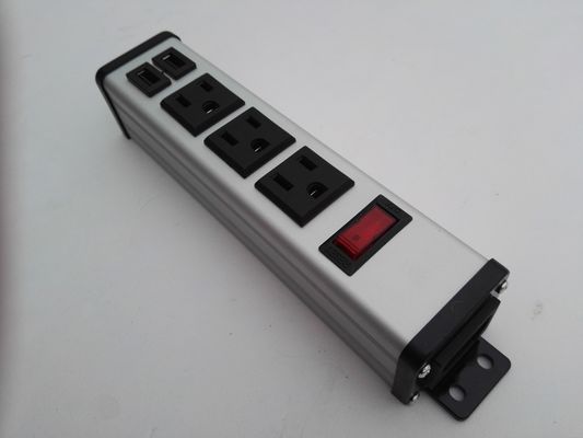

Even the one with the screws in it has keyhole slots in it's back.
The clamps can be loosened and the plug strip just snaps into the clips. The closed oval can be hung off of cup hooks, finish nails, etc.
All are removable.
They're listed as Relocatable Power Taps for a very good reason.
Junction boxes, panels, etc. that are screwed down would not be considered "relocatable" by any stretch of the imagination

Interesting. Without further details it's hard to know what type of power strip it is, but from the UL page: "There are numerous types of power strips including, but not limited to: furniture power distribution units, multioutlet assemblies and relocatable power taps."
FPDUs can be permanently mounted, RPTs are intended for temporary mounting only whatever that is. There's a reference to the use of tools for mounting which may decide that. Wing nuts OK, hex nuts not OK?

So why do they come with keyholes or ears meant to be screwed down?
IDK, but it's code. "NFPA 70, RPT are for use as a movable power supply connection for cord and plug connected electrical utilization equipment and shall not serve as fixed wiring of a structure or of fixed furnishings, such as but not limited to applications in permanent countertops of kitchens and bathrooms."
Basically, relocatable power taps are not intended to be permanently secured to building structures, tables, work benches or similar structures and cannot be used as a substitute for fixed wiring.
