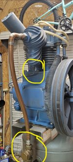

Got another question. Got a small air leak. In 10 minutes losses 5 psi. I sprayed soapy water on ALL thread fittings and no bubbles anywhere. See attached pictures. I circled the 3/4 check valve in the one picture...could that check valve be leaking air back up into the cylinder head. How can I check to see if it's faulty? Also the small tube that runs from the head down to bottom of the pump, is that the pressure bleed off for the cylinder heads? Is that for allowing the motor to start easier, the pressure escapes from the heads by way of the tube? I don't really hear anything from the end of the tube when the pump stops on set on pressure. Would like to be able to keep the tank pressurized without the motor kicking on for days if possible.

The Cobbler
Oct 24, 2013
26,139
yes
yes, it can be leaky . since your discharge line is soldered it would have to be cut apart ...but basically just take the line off the check valve spray soapy water in there & look for bubbles... or not.
to me it looks like a water check valve, not a pneumatic check valve , I'd be suspect
but, did it lose pressure right away ? heated air cools & becomes smaller so it will lose pressure at first . if it continues to lose you have a problem

Thanks for your comment....it loses complete pressure in about 2 hours. I did check the water drain valve at the bottom of the tank with soapy water...no bubbles. Yes ,would have to cut the main copper air supply line because it's soldered. There looks like there's a screw in cap on the main air check valve, wondering if there are parts inside that could be replaced. Going to take it apart. Don't know if I could even find internal replacement parts for it.

Ok....bubbles out the unload tube....see bubbles..?lol. I opened the main inlet check valve. Clean it up to no avail...still leaking. I ordered a new check valve. I'll let you guys know how it goes...thank again for everyone's help....talk to you Gents later. 20240406_153900_1.jpg

Thanks ...tried to clean it ,didn't work. I replaced with new check valve. New valve did the trick. I other question, thinking about changing the oil..what type do I use?
