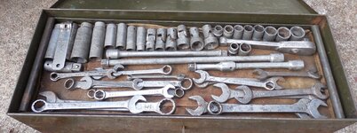

I dragged this toolbox out of hibernation a few days ago and took more photos of it and it's tools. The owner ground three notches on a lot of the tools in the box to ID them as his. Also he sure had a lot of extensions to work with. Looking at the MAC wrenches etc. again the finish on them is poor compared to a lot of other similar tool sets, but they are all intact and usable so they have what counts. All the socket tools are marked with an "X", which I think is an odd letter to choose to designate something, did MAC use the X to mark all it's socket tools? Or specifically it's 3/8" socket tools?

That double-end flex handle is neat. I have one of those speed-wrench handles in storage, but don't think it will fit in the box these tools are in, and it seems to have a brighter more conventional finish than these tools.

That speeder looks Herbrand shaped. And the ratchet has a certain Herbrand look to it, with the sliding selector.
Did they make this for MAC?
30,914
If anyone can make a good guess as to the year of this set that would be great.
Mid 40s. A few years ago I posted some info and dating analysis along with a set of seven (7) sockets in a NOS cardboard box and the same ratchet in the MAC thread here. Found a swivel joint to go with the set later. Not nearly as many pieces as that set you have, obviously, but exact same production era.
