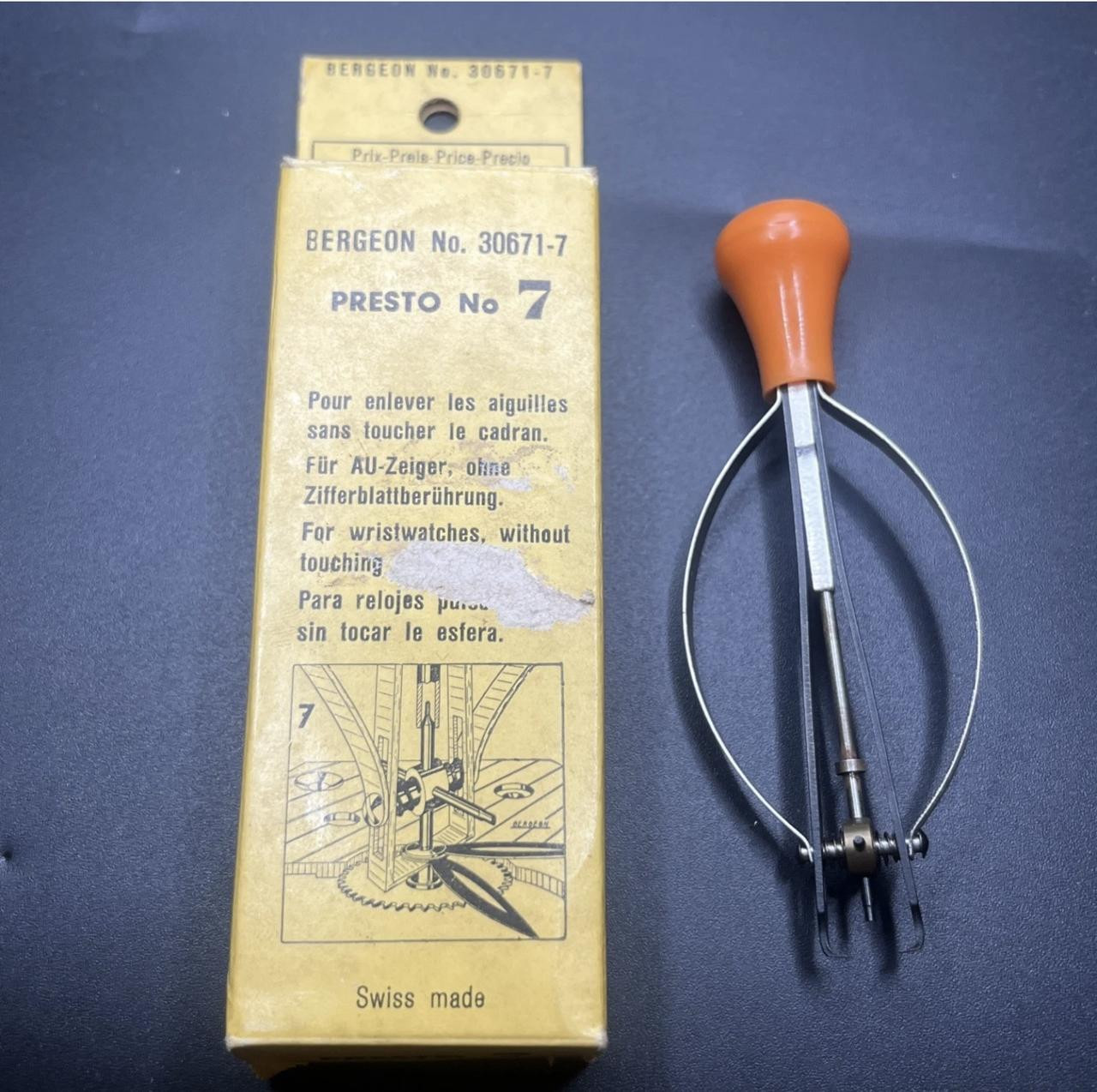

Now I know where all the hand rested tool went! LOL! I bet you have a large collection of 10mm sockets too! LOL!
Your hand puller on the left looks like a genuine Bergeon presto hand removal tool that currently sells for $150. I hear they work well.
The first hand puller / setter set I bought were knockoffs of ones they sell on Esslingler and were total garbage! For $15 it was worth the price to give it a try.

It is a Presto 4.
Thanks! I just looked up the Bergeon Presto 4 and 7 and like that they push against the cannon pinion instead of the dial face! I can see how that would be much better for these indicators because this immediately made me think about the load on the pinion holder spring when I pulled the hands. Your post just cost me money! LOL!

It is a Presto 4.
Your post did cost me money. I just bought a new old stock Presto 7 on eBay for just under half the cost of a new one.
I checked and it’s supposedly the best hand remover for my Seiko watches and I confirmed that the pinion diameters on my dial calipers are within the range of the Presto 7.
