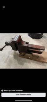

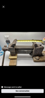

New to this forum, and just started getting into vintage vises. This is a vise I just picked up and was wondering if anyone could tell me anything about it.
As you can see, the number is not entirely legible I believe it is 941 (under Lewis Paent). I plan on restoring this would love to hear what anybody has to say and informative or just comments and if anyone may know what it might be worth if anything I don’t plan on selling it at this point I believe it’s gonna look very nice on my workbench.
Would like to say thank you in advance for any information you can provide on this particular vise.

Your vise is a turn of the 20th century Lewis Patent Prentiss dating from around 1910 if I had to guess. Here is a picture of a Lewis Pat. Prentiss from the 1910 catalog. It's not the same model as yours but you get the idea.
The open screw models generally don't bring big money but are plenty stout enough for a homeowner. If I saw this vise at a flea market, I'd pay a max of 30 bucks for it just for the novelty of it being a Lewis patent. Value greatly depends on where you live. Around here, vises are plentiful and hence the market prices are low. I can drag home all the old Prentiss machinist vises that I want for under 100 dollars.
Welcome and post pictures of your restoration. We love that sort of thing around here.
