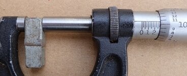

Probably nothing new, but don't remember seeing pics of this on here. I picked up a nice 1/4" sized Craftsman ratchet a long while back. Old one, which had a female square drive, not the typical male square drive that we have on ratchets today
it sat in the drawer for a year. Playing in the garage the other day I decided to make it usable.
so I took a spare hex-to-1/4" square drive impact driver adapter I had, ground it down so it fit the female square, cut it down so it barely stuck out the backside, and welded on a washer to retain. 100% reversible but 200% more useful now
Super simple way to wind up with a 3/8" or 1/2" stubby too if you had a need with 5 minutes of fab

The OP says that he has welded the adaptor to a washer and NOT to the ratchet.
thank you for reading.
2 minutes with a grinder and its back to original. but now it's not trash, its actually useful. A coupler like shown above would just fall out. I'm sure it'd work, but it'd **** to use
maybe I should actually butcher it and make you guys happy ;)
