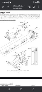

Hello guys and girls.
First off thanks for letting me join the site.
Secound thing is iam looking for any one that might have an idea of what kind of 3 to floor jack I have .
I Bought it about 24 years ago at canadian tire and now it needs rebuilding can't find any reff numbers on it to get a seal kit ,and it sure looks a bit different than most old jacks I have seen .I will send a pick of the valve body seems to have an extra screw port the lowering spindle is held in place with a set screw there is the plunger valve and 3 other ports iam at a loss thanks in advance if you can help 1000001532.jpg1000001533.jpg

Iam at a lose as to the lay out of the ports .
This is what I can figure or what I think the set up is .
First hole plunger.secound has 2 ball one small one bigger next the up down gear wheels then hold down screw next not sure next factory set for max lift.
There was a ball that came flying out of one of the last 2 ports lost it not sure what or were that one goes .tryed to find a schematic drawing for it no luck the numbers I see on the lever holder don't bring anything up .I don't want to get rid of the jack as the metal is all solid better than the tin **** they sell now a days.
If you come across any drawings that come close sure would make my day .
Thanks again

A picture of the full jack would probably help. It'll probably match up with some other brand.

Hi .
I will post a pic .
I think it the same as big red China stuff.
Bought it like for ever ago all branding mostly gone does say motomaster speedy lift on it

Much appreciated any help is a good thing.
I did find this and iam hoping it will help me out .
Love the old jack,but solid.
