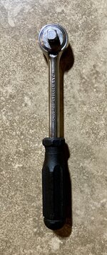

Wright tool also made dual pawls several years ago in a 3500 and 4500 size. I can’t find a current picture of the inside or the patent for it but I saw it when I cleaned it up. It is dual pawl.

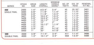

This is from a late 70s wright catalog number 500A. They had dual pawl back then in Deluxe model 1/2 drive 45 tooth with 90 tooth action and 3/8 drive 41 tooth with 82 tooth action. My 3500 is all original dual pawl except the handle. My pawl looks like the one in this picture.
