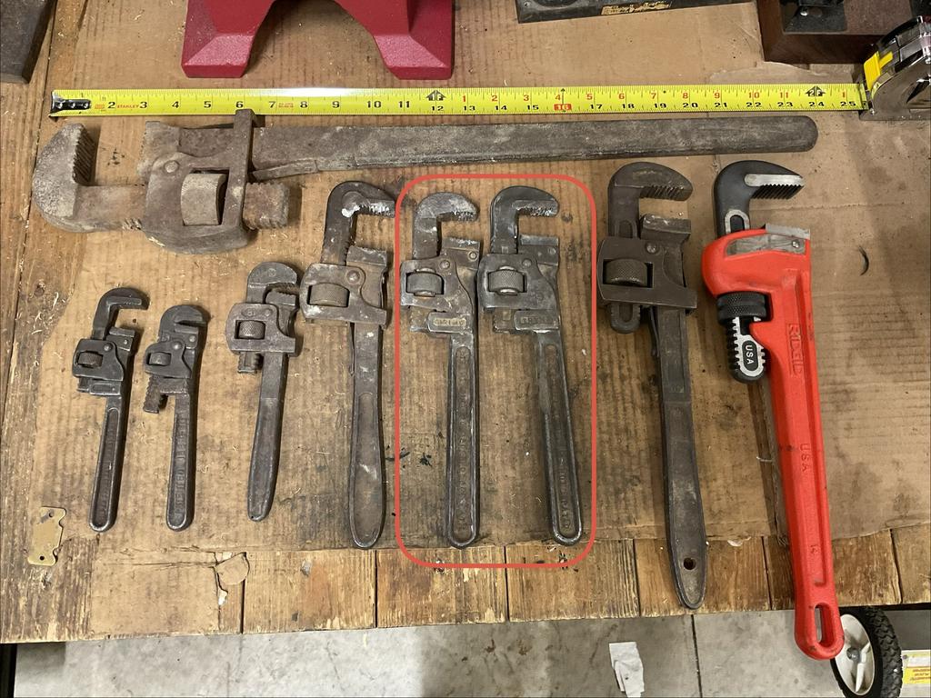

Where did you buy such small pipe wrenches? Were they salesman demos ?

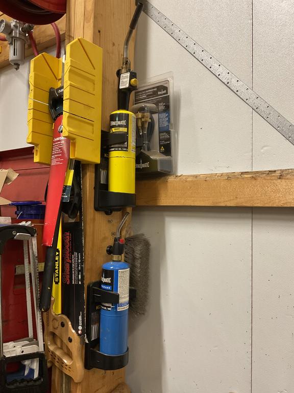

A propane torch is NOT the torch I was mentioning. Propane doesnt get hot enough.
You need oxy/propane... or an induction heater. You need to get the metal at LEAST pink... verging on red. That little propane heater is doing nothing.
Also... you should use the appropriate sized wrench (and possibly a cheater bar) - NOT pipe wrenches. Thats how you chew up the flats on the tie rod.

The pipe wrench I used on the bench is 2’ long.
The Trimo pipe wrenches I tried under the lift (circled in red) were about 10” long.
The old rusty pipe wrenches were my grandfathers I added the new rigid pipe wrench a few years ago.
I did add a map gas torch. I thought about getting an oxy-acetylene torch but I wouldn’t use it that often.
