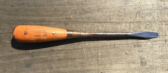

Need a little advice on this screwdriver. I want to replace the wood cheeks on the handle ... no problem there. Need help with the rivets.
One thought i had was a flat head bolt grind the head enough to remove the groove. Then cut to length and peen the end over, into a countersunk hole. A second thought is copper rivets, like for leather work.

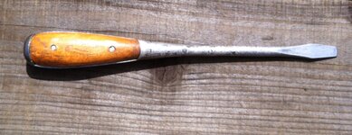

I made some little dowels and glued them into new walnut cheeks when I repaired one. It's on light duty but has been fine for years.

I wanted to transfer some ink marked handles from a 9-1/2” screwdriver blade to an 11” blade. I carefully drove out the rivets with a small drift doing as little damage as possible. Once I had one handle off, I filed off the edges of the smaller peened rivet ends. After I transferred the handles onto the blade, I tapped the original rivets back into place and carefully re-peened the original rivets enough to keep the handles in place. Unfortunately, I noticed that the handles were slightly narrower from the shorter driver so the experiment was a failure.

It does look good. But the rivets are wood, i want metal.
Try knife making hobby web sites.
I dropped a kitchen knife a couple of years ago and one side of the handle popped off. A perfectly good piece of steel so figured I try.
The hardest part is finding the rivet you like and fits. It took me two purchases but I don't mind having extra hardware around.

I had not thought about knife rivets. That could work.
