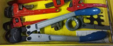

I have the Zurn/Qest 1/2" crimper, and it's served me well for years. I have a need to do some 3/4" Pex, and I thought about buying the 3/4 crimper that matches this one, but they are pretty expensive.
I probably won't use the 3/4" crimper as often as I use the 1/2", but I don't want to buy a cheapie and risk bad crimps.
I guess I am just asking what do you guys use? Are any of the cheaper crimpers any good? Or should I just bite the bullet and get the Zurn/Qest crimper? The OCD collector in me really wants the matching one, lol.
Here's a pic of the one I have:

Just an update- I had to do some pex work the other day, and I had to use my trusty 1/2" crimper. I thought "I really like this thing, I should just get the 3/4 version". So I did. I kept my eye open, but I could never find one for less than $80. Somebody finally listed one on ebay auction-style, and I won it for $15! It's used and it's got a little schmootz on the handles, but it'll do just fine. Here's a pic of when it arrived, and a pic with it's 1/2" brother, lol.
Yeah, these big ones aren't great for confined spaces. But honestly, I've done countless jobs with mine, and as long as you plan ahead (and don't plumb yourself into a corner, so to speak, where your last crimp is too confined), you'll be fine.
