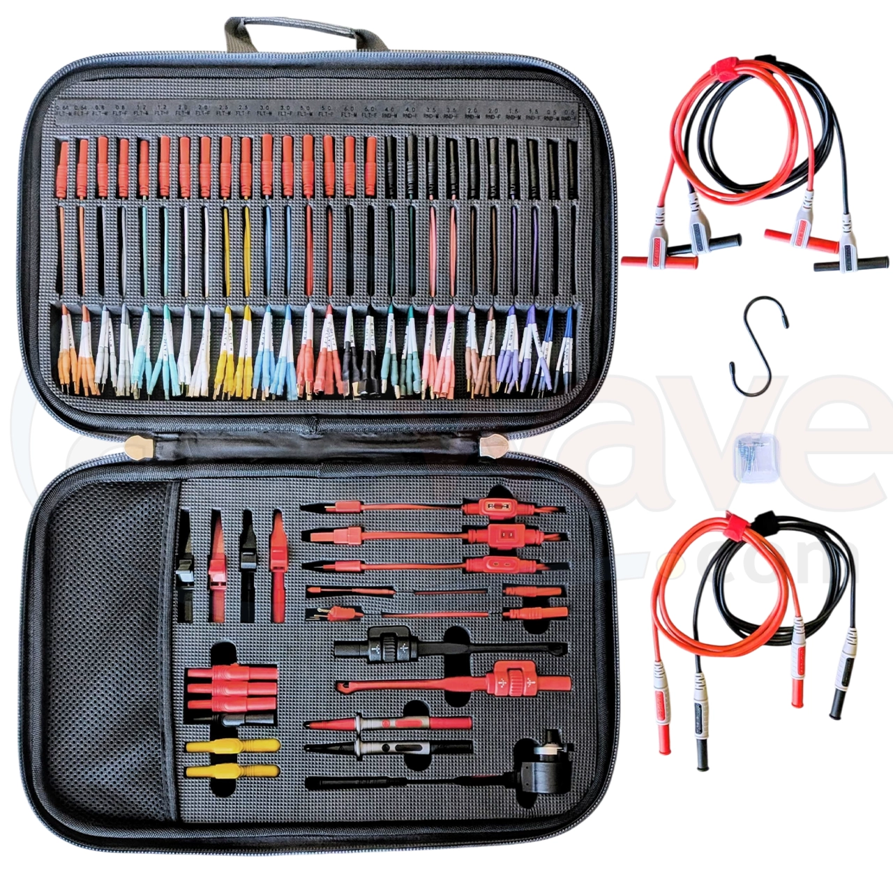

AES Wave has a tool that does the same thing but it doesn't fit on a keychain and it's expensive and multi-purpose: https://www.aeswave.com/products/ut...t-kit?_pos=5&_psq=utest&_psid=0f007f9dd&_ss=e
That kit is THE standard for doing extensive electrical diagnostics. I have one and it's glorious.
Can you get by without one? Maybe, but why would you want to make life more difficult? There's a reason Eric O, DiagnoseDan, ScannerDanner, Pine Hollow Ivan, Keith Defazio, and others have them.
It looks expensive, but when you consider everything that's in it, it really isn't. It costs about one hour of diag time at a good shop here so it paid for itself the first time I used it.
