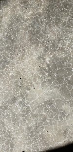

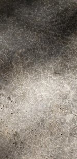

I'm not trying to hi-jack this thread, but it is possible I also have alligator cracks. this floor was poured just 30 days ago.
Is this a serious problem?
Will it lead to spalling in the future?

You have what is called surface crazing, which is basically shrinkage cracks in the paste on the surface of the concrete. It is not uncommon, doesn't usually get worse or lead to additional problems. It can be indicative of a higher than optimal slump during placement or poorly managed bleed water but neither is usually fatal.

Thanx LLWillysfan
The concrete company owners came by last week to look it over. The said essentially the same thing you did above. They felt a contributory factor may have been the 10 MIL vapor barrier I paid and the 2" insulation: the water in the pour could not leave the pour by going down.
