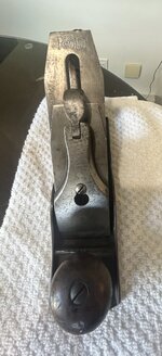

Hello, I’m hoping someone can help identify this plane. Might be a Frankenstein with different makers but not sure. Has a nice thick iron marked R.H.S.B & Co. REV-O-NOC. The plane has a very unique triangle shape where the frog affixes to the bed. The plane is 9 1/2 inches long, under the rear handle the edge is slightly raised from the plane bed. No other marks at all, the lateral adjuster has a twist at the top. I believe Stanley would sell frogs to other companies and sometimes twist the lateral adjuster. My guess was Birmingham plane, but I haven’t found any with all this characteristics. Thanks for looking.

The HSB is Hibbard, Spencer and > Barlett (a large Chicago based hardware firm). Their planes in the Revonoc line were manufactured by Stanley and Sargent
13,386
REV-O-NOC
Is Conover backwards. I forget who he was in the grand scheme of things .
Here is another useful link on them
As said above, Stanley by indicators, not Sargent, as the link says is an option.
