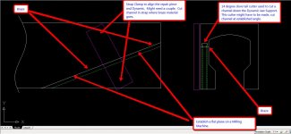

I would love to hear suggestions about repairing the broken off rear corner of the slide.

You cannot repair that easily, if at all. Most of us would have passed on a vise with a chunk of the slide missing.

Not sure most would pass on that, it's a 7", don't think I've ever even seen one. If it was a more common 6" or under, sure, pass. I think the way to repair it would be to either get some cast iron bar, or maybe find another broken vise for a donor piece of a slide, and weld/braze it on. I think I've seen similar breaks repaired with steel as well, might be a little trickier. Pretty sure there's a similar repair buried in the vise mega thread, remember seeing it. I'm wondering if the vise was dropped at one time, seems pretty difficult to break any other way. I think once repaired it would be fine, can't be much stress there usually, not to mention how often would it be open that far. For most uses, it would probably be fine even with the chunk missing.
Good luck, Jim

Andy, here is how I would repair a break like that. I would choose to braze in a new piece of cast iron. Having the right equipment is essential, I get calls all the time where the person just bought a Chas Parker with no jaws and figures they are a dime a dozen. You can purchase cast iron at McMaster Carr. I added a view of the page.
I would set up the dynamic jaw support either in a vise or on a sine plate then established a flat surface and create the cut angle. You could just cut a slot and reproduce it in the cast iron but I prefer the reversed drafted cutters. I would leave about .005 clearance for the brass. If you can make the side replacement piece about .02 proud then you can cut the side to match the square slider. Then braze it.
Your question is not a easy one to answer with out better pictures of your vise and not knowing your abilities. I created a quick drawing with notes. Welding would be last option since it would be brittle.
