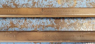

Are these Plomb? No other markings.

I am far from an expect in Plomb, but I believe those are Proto that the brand was milled off. Apparently they did this to factory seconds that were sold to employees. Other tool companies had the same practice that basically voided the warranty.
The fractional sizes are inside what they call a "pebble field" These were shortly after the Plomb pebble style wrenches and after Plomb name changed to Proto.
