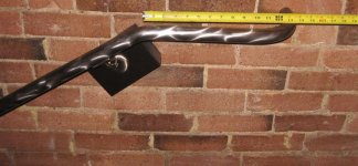

Yeah I do mine on the lathe, but only messed around w mild steel thus far. I use a Scothbrite pad on my angle grinder. Tried stainless but couldn't get a good pattern 'cause stainless is so tough. In hindsight I shoulda just used an abrasive sanding disc on the stainless, probably would have worked well.
For the best pattern I first use a slow spindle speed, around 40, and then kick it up to 120 or so and go again.

Never tried it on a lathe, but when i did it on a valve cover with an airtool it looked nice, but you could see the "swirl" patterns it left.
