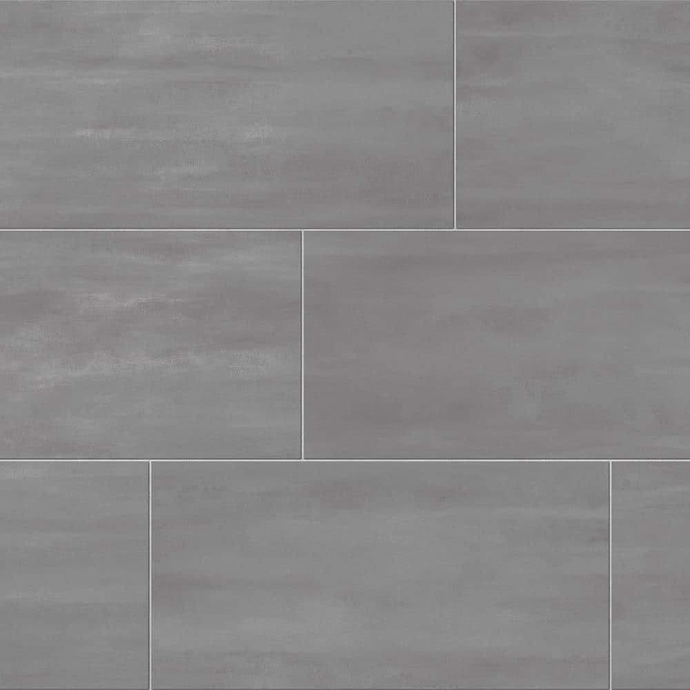

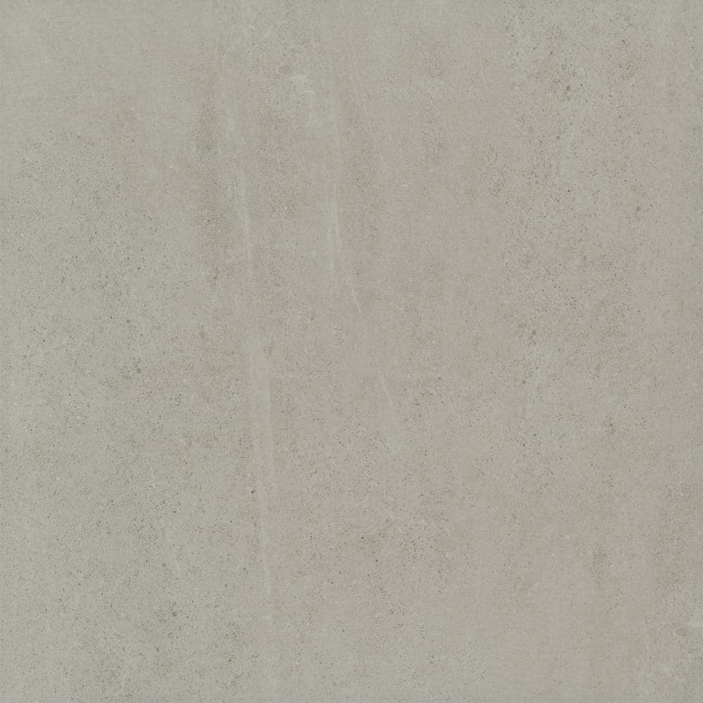

Any thoughts on this tile from Home depot? It's 18x18
Pei IV is good. Should be pretty slip resistant.
A problem with cheap tile is flatness and defects. I'd get my hands on a few to check for flat and buy lots of extra. Home depot will take back the unused stuff, no problem.

I had my kitchen done with some large format tiles and the installer didn't inspect them carefully. He ended up installing several that had a bump from what looked like a rock under them. I know look at every tile I install, which is easily done in the initial layout planning. Also allows you to check for color and pattern.
I am no tile pro, but have done a few rooms. Any stress that I can take out of the actual laying process is a win in my book. The last one that I did was a 6'x8' landing with 2"x10" tile in a herringbone. I cut almost all of the tile in advance and laid it out with spacers, then carefully broke it down into organized piles. Came out pretty good

So, they list this as a Grade 1 tile but that is completely meaningless.
Generally, the highest grade of tile will be sold at the pro stores. Stuff that is just below that grade is sold to other places. However, everything a place produces may be pretty much the same so what you get at the big box stores may or may not be just the same. Generally, it is stuff that is no longer being sold at the pro places so it gets sold to box stores cheaper cause its not the HOT new item. You usually will not find the same tile on the shelf at HD as you would at the Emser store.
You will find the occasional bad tile in the stuff from the pro stores too.
