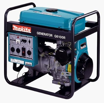

I have had a Makita 5500 Watt generator for about 23 years. I get it out and run it for a while once a year and keep it in a heated building. I also keep it full of gas with stabilizer. After I use it (every couple of years) I change the oil and fill the gas before putting it away. It has electric start but because I use it so seldom it never has a good battery. I figured that if it got hard to start I could jump if from my truck or tractor. So far, it has never failed to start on the second pull of the rope.
